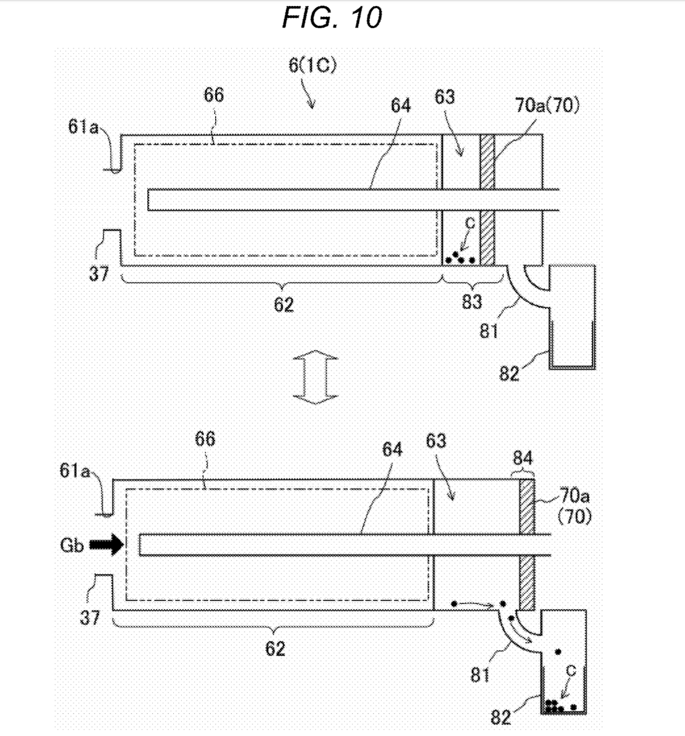

Think of a decomposer as a type of catalytic converter. The engine’s exhaust gas in the exhaust stroke is used to carry injected fuel through the decomposer, and heat up the catalyst so it functions correctly. Hydrocarbons in the fuel that was injected into the exhaust air pass through the decomposer, which separates the carbon and hydrogen, trapping the carbon and letting the hydrogen pass through. Mazda Six Stroke Engine Patent 4
Here’s the inside of the decomposer. On the left, the exhaust gases enter, and only the hydrogen is able to pass through.
Source: USPTO
In Mazda’s patent, both the carbon and the hydrogen are immediately stored elsewhere in the car—the carbon to be removed later during a routine service is stored in the decomposer, and the hydrogen to be re-injected into the engine to act as a fuel is stored in the “hydrogen fuel supply section.” The fifth stroke takes air back into the cylinder, while the sixth stroke finally pushes air into the atmosphere. From the patent:

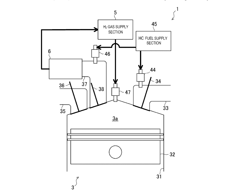

Mazda Six Stroke Engine Patent 1
Here’s a cutaway of the cylinder head, showing a third valve with a path to the decomposer and how the scavenged hydrogen gets back to the combustion chamber.
Source: USPTO
For one thing, Mazda’s idea seems incredibly complex. The patent drawings make this concept look simple, but it would involve adding several new parts to the cylinder head—one of the most crowded parts of a modern engine. An entirely new valve path is needed to direct the exhaust gases to the decomposer, and another injector has to be added to feed the decomposer, and one to feed hydrogen into the cylinder. Not to mention a tank for the hydrogen needs to be placed somewhere onboard, and space needs to be made for the decomposer itself. And as Mazda points out in the patent, it would need to employ hydraulically or electronically controlled actuators for the valves, similar to Koenigsegg’s Freevalve tech.

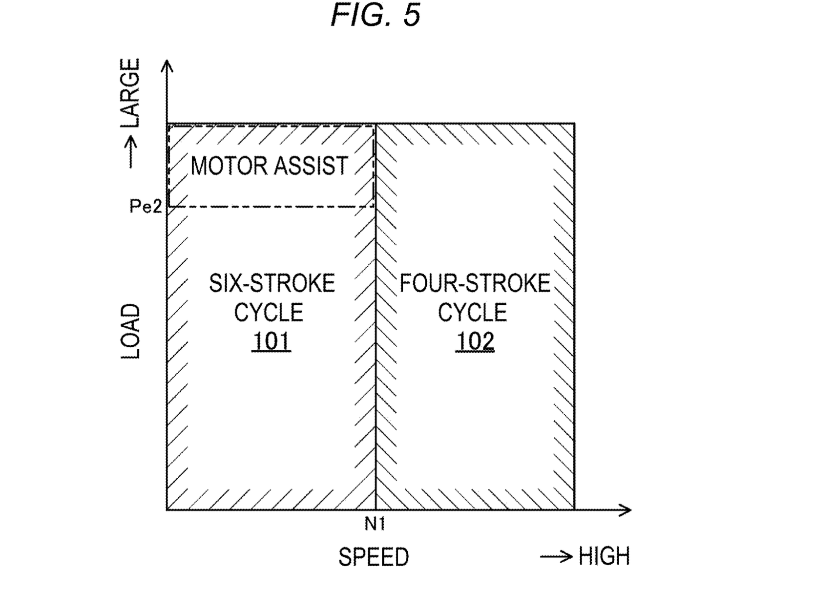

A flowchart showing how the engine decides whether it’ll run in four- or six-stroke mode.
Source: USPTO
Plus there’s the control strategy. Here’s a little example, which references the image on the left and the one above the one directly above:
“if the engine 3 is operated in the first region 101, the controller 21 executes the operation in the six-stroke cycle, that is, the operation using the hydrogen gas as the main fuel (step S4). On the other hand, if the engine 3 is not operated in the first region 101, that is, operates in the second region 102, the controller 21 executes the operation in the four-stroke cycle, that is, the operation using the hydrocarbon fuel as the main fuel (step S5)…When the engine 3 is operated in the six-stroke cycle, the controller 21 estimates the carbon deposition amount in the catalyst 66b based on the signals from the hydrogen gas sensor 25 and the like. When the carbon deposition amount is excessive, the function of the catalyst 66b is impaired. As a result, the produced amount of the hydrogen gas is reduced [0155] The controller 21 compares an upper limit value Ds of the carbon deposition amount, which is set in advance based on an experiment or the like, with an estimated value De of the carbon deposition amount (step S6). As a result, if it is determined that the estimated value De of the carbon deposition amount is equal to or greater than the upper limit value Ds of the carbon deposition amount, the controller 21 executes a carbon removal mode (step S7).
