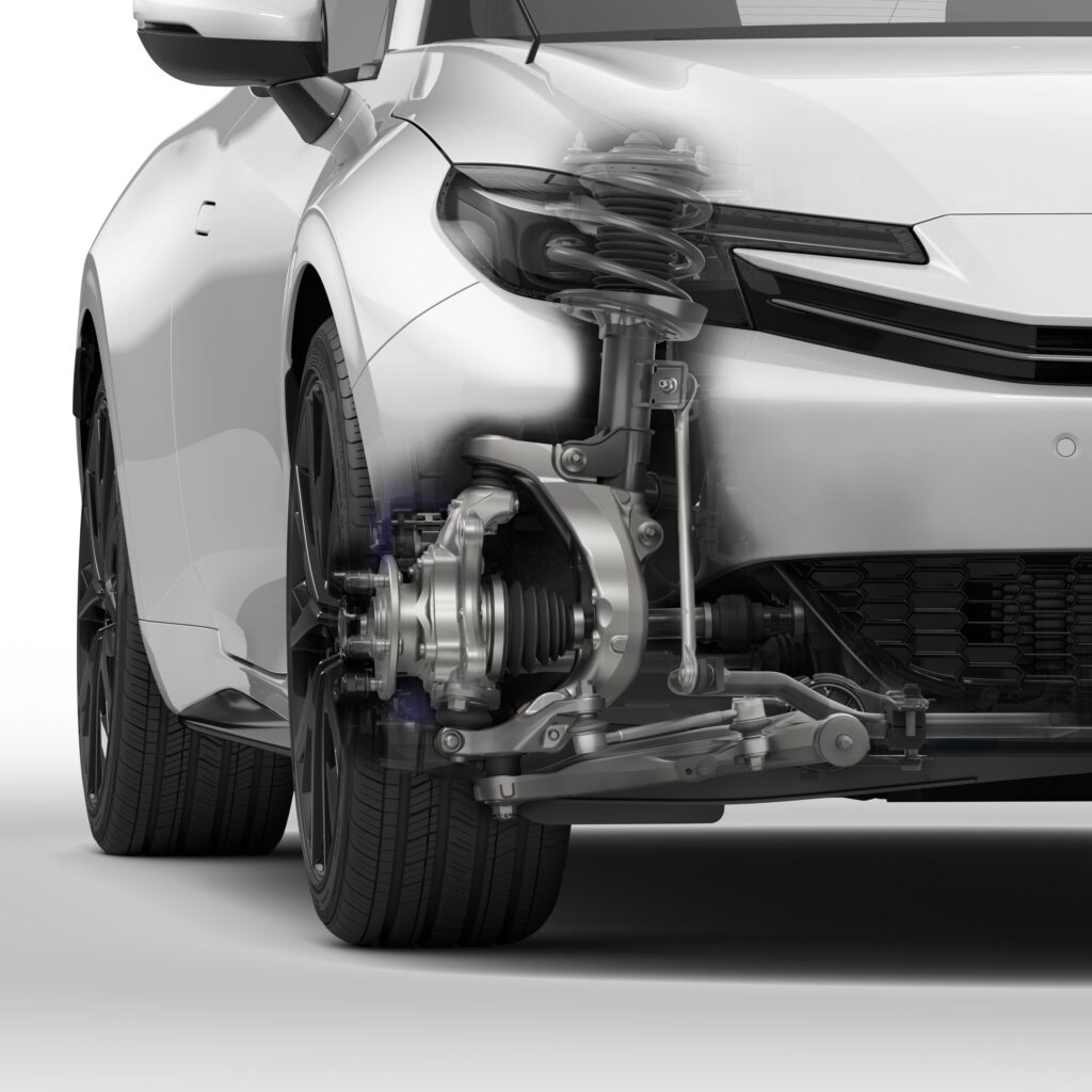

The chassis benefits from parts from a different Civic—the Type-R hot hatch. Ars has sadly yet to sample the current-generation Type-R, but everyone I know who has who's driven one has come away smiling. Type-R parts include the front suspension's dual-axis struts and the Brembo brakes, which are there for when regen braking via the hybrid system is no longer sufficient.

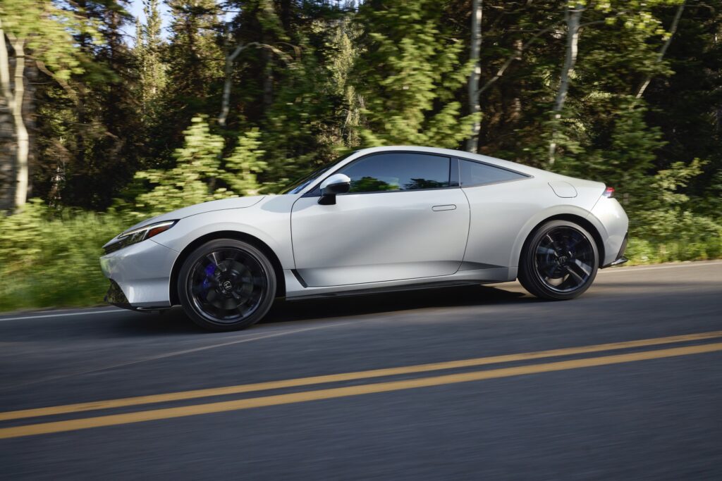

A white Honda Prelude drives past the camera
The shape is dictated by airflow. Credit: Honda

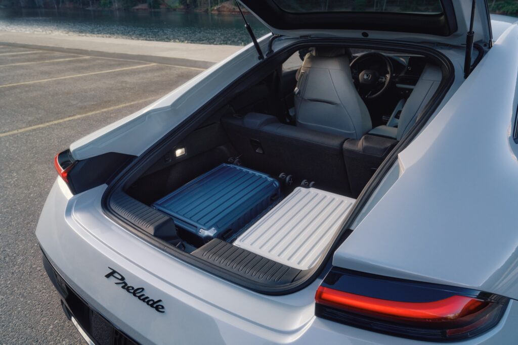

Honda Prelude trunk
There's 2+2 seating and room for luggage. Credit: Honda
Honda Prelude front suspension cutaway
The front suspension. Credit: Honda

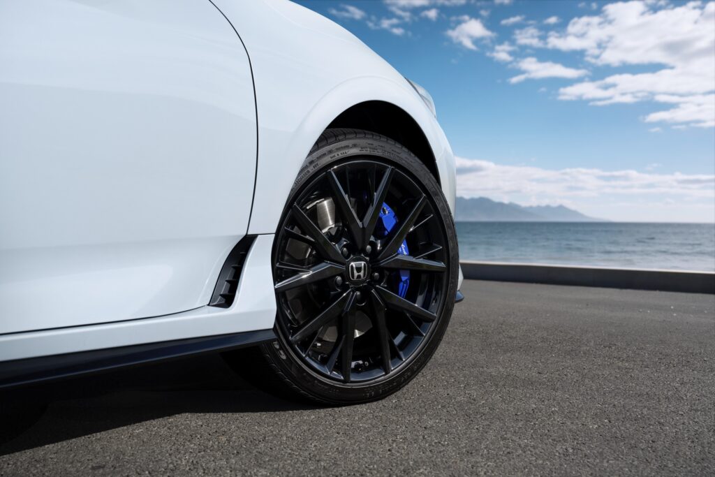

Honda Prelude wheel
Berlina Black wheels are an option. Credit: Honda

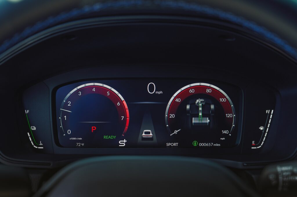

Honda prelude dash
Again, very Civic. Credit: Honda

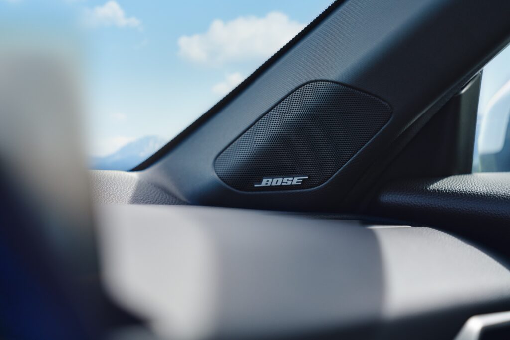

Honda Prelude A pillar with speaker
Bose speakers are standard. Credit: Honda

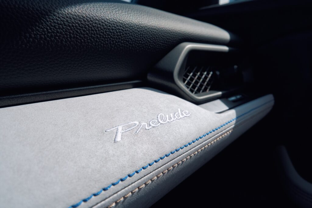

Prelude stitching on Honda Prelude dash
In case you forgot. Credit: Honda
